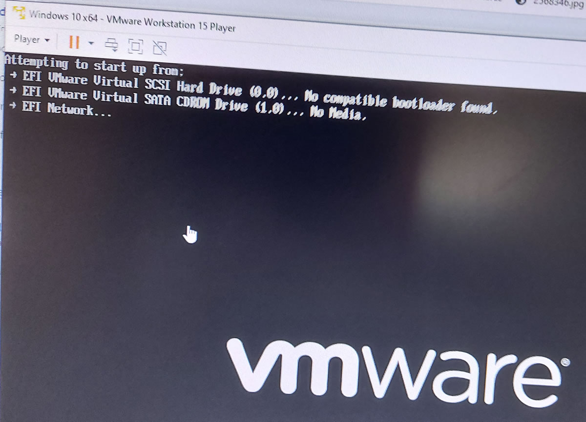

I used StarWind V2V Converter to convert my PC to vmdk in an external hdd
But I can Not boot from vmdk in Vmware Workstation pro
Maybe this due to being in the same PC I created the VM from? Is May having conflicts? Between c:/ and the vmdk from this c:/
I proceed to start VM[VMWARE WORKSTATION PRO 15.X] :
https://youtu.be/NK9745csJgc
VM can Not boot up // SEE ERROR AT 05:27 & 06:27 in the video
what choose at in the video at
01:47 UEFI / OR / BIOS   ????
in the video at 04:05 CONVERT TO NEWER FORMAT  ????

is my C:/ drive - c:/ disk converted[with starwind v2v converter], with recovery partitions
PLEASE REPLY - ANY POSSIBILITY OF CONFLICT:
I HAVE boot the VM[VMDK - CONVERTED FROM MY C DISK], from the same machine I got the vmdk from... may have conflicts[the UEFI - same c:/ disk signature???] the actual c:/ with the vmdk/c: ????
Fri Sep 04, 2020 7:52 am
Greetings,
1. there are no conflicts. Just convert that disk to VMDK, and add it to the VM. It really helps if you provide us with any screenshots or tell what exacly error you have.
2. chose BIOS as a boot option.
VM can Not boot up // see error in the video at 05:27 & 06:27 in the video
So the error due choose UEFI
Have to choose BIOS instead... even my system was uefi... true?
On Mac Vmware Fusion
Or Windows 10 Vmware Workstation pro
Have to choose BIOS both?

Do you know what to try, getting: // ...?
see attachment

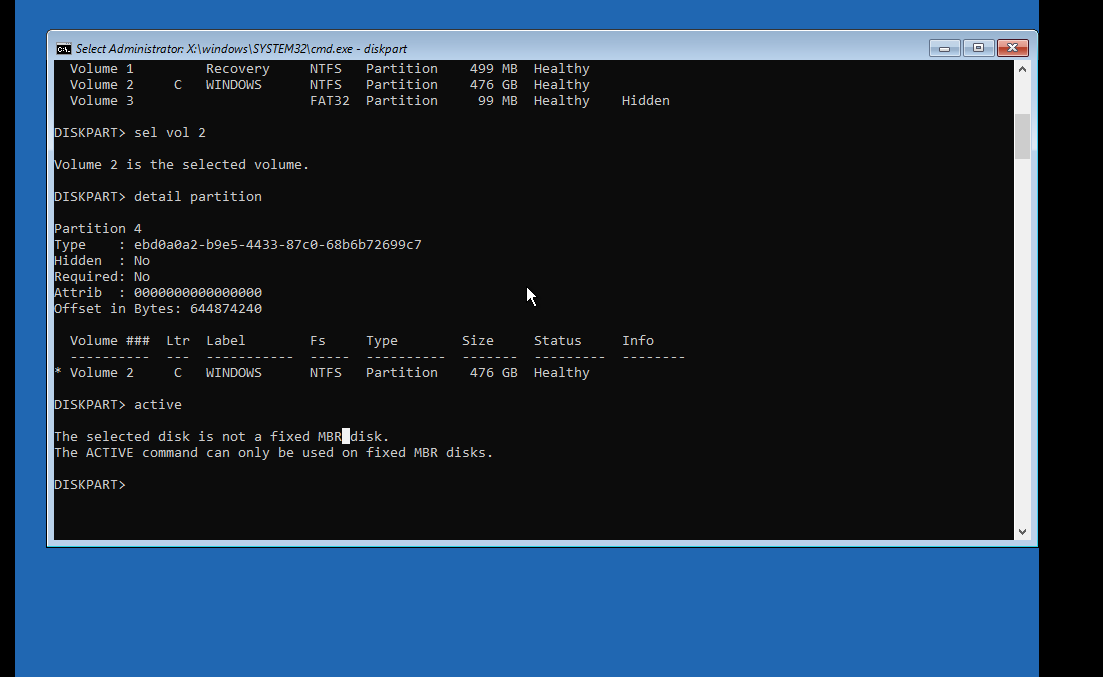

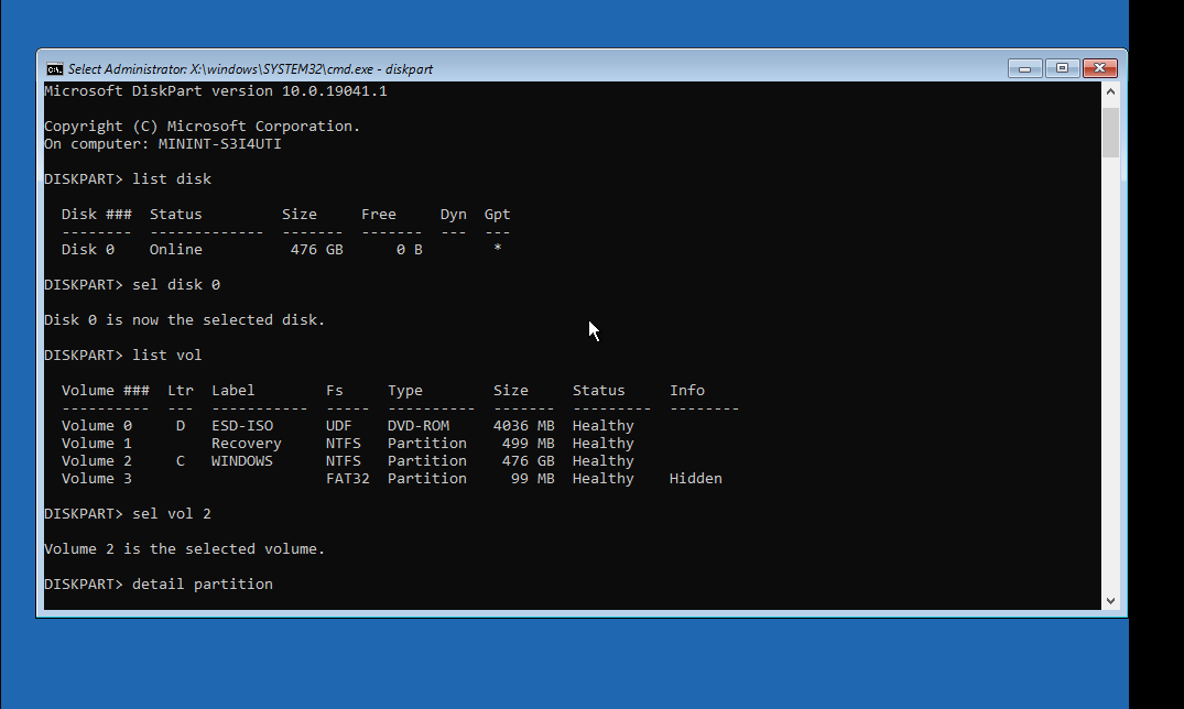

diskpart screenshots
Any hint of what to try????

Vol 3 in my case is the efi partition? How find system partition
https://docs.microsoft.com/en-us/window ... techref-di
Repair the system partition
If the system partition has been corrupted, you can use BCDBoot to recreate the system partition files by using new copies of these files from the Windows partition.
Boot your PC to a command line. For example, boot to the Windows installation disk and press Shift+F10, or boot to Windows PE (WinPE: Create USB Bootable drive).
Use Diskpart to determine which drive letter contains your Windows partition and system partition (diskpart, list vol, exit).
Optional: Format your system partition: format (drive letter of your system partition) /q
Add a boot entry for your Windows partition: bcdboot D:\Windows
Reboot the PC. Windows should appear.
lsepolis123
Posts: 13
Joined: Thu Sep 03, 2020 6:38 pm
Sun Sep 06, 2020 7:52 am
In my case give the command in cmd line
bcdboot C:\Windows

I gave this cmd
bcdboot C:\Windows
when booting in VM from ISO Windows 10 2004, and went in cmd prompt
Now boots OK
