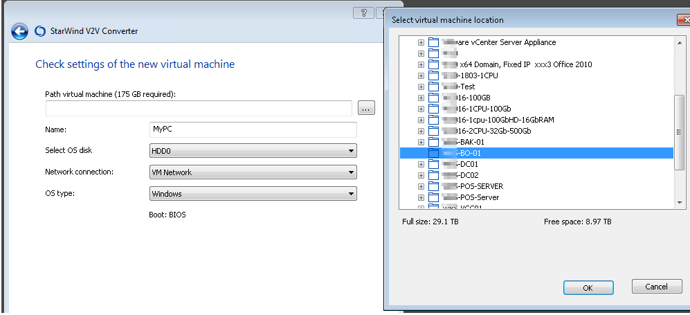

What you need to do is set the ESX physical host IP as the target. Then you will see Datastore sub dirs which can be chosen as the target.
2020-08-14 16_35_00-Photos.png (24.7 KiB) Viewed 11330 times

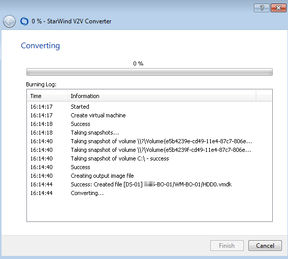

After this the conversion starts almost instantly, and the log starts to be written.
2020-08-14 16_37_05-Photos.png (15.58 KiB) Viewed 11330 times
So in conclusion - use the Physical Host as the target and NOT the vCenter appliance.
