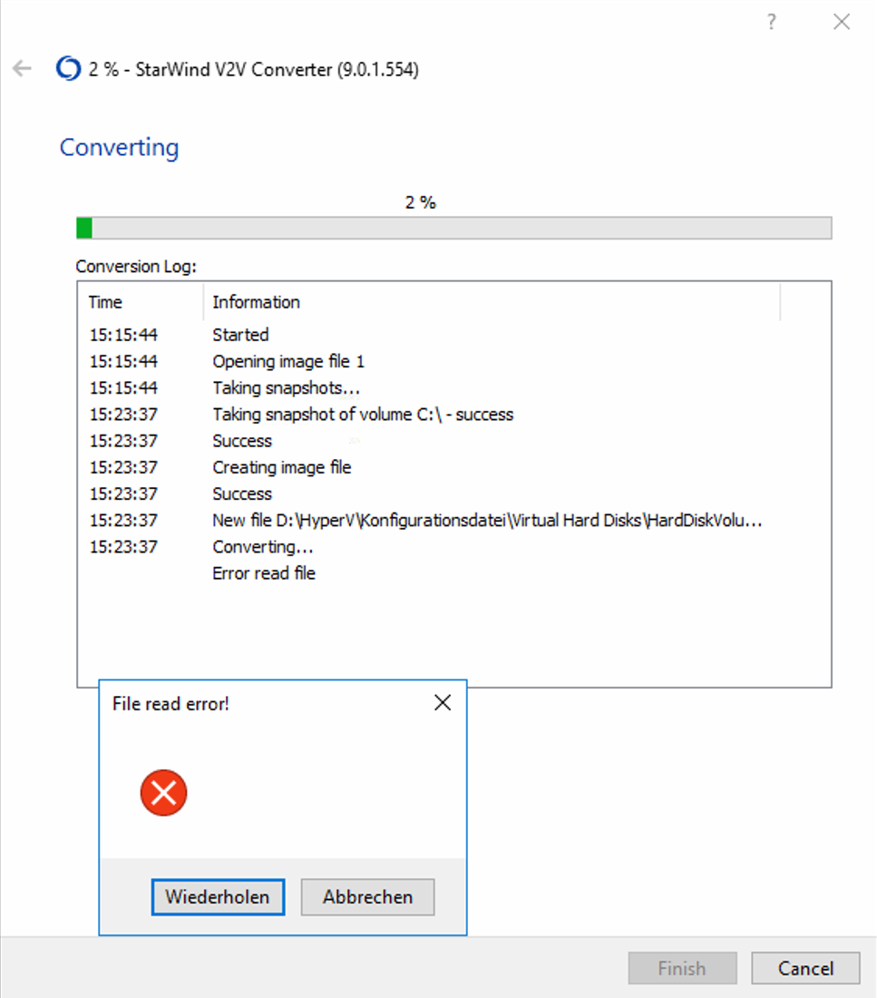

Dear StarWind Forum,
I hope you guys can help me. I am trying to P2V convert a Windows Server 2016 Maschine of a customer and always get the following error as soon as it trys to convert the c:\ drive
I am trying to convert to HyperV but I also tried to convert local and this also doesn't work. I am out of ideas.
???WARNING: P2V::getBuffer: ReadFile - 21. Das Gerät ist nicht bereit. (Translates to Device is not ready)
11/13 20:04:26.651 a510 Facility ???ERROR: CPPConverting::ConvertImage: Read 3
11/14 8:13:56.484 a510 Facility ???ERROR: CPPConverting::ConvertDisks: ConvertImage - 2
11/14 8:13:56.576 a510 Facility ???ERROR: CPPConverting::Convert: FAILED
or
11/14 13:59:42.300 5510 Facility ???WARNING: P2V::getBuffer: ReadFile - 2. Das System kann die angegebene Datei nicht finden.
11/14 13:59:42.300 5510 Facility ???ERROR: CPPConverting::ConvertImage: Read 3
11/14 14:00:31.612 5510 Facility ???ERROR: CPPConverting::ConvertDisks: ConvertImage - 2
11/14 14:00:31.624 5510 Facility ???ERROR: CPPConverting::Convert: FAILED
Converting the Non-System Drive is not problem but as soon as i am trying to convert the system drive it gives me this errors.
thanks for your help in advance

I just checked if there is any encryption on the system and as far as i can tell its not. I am doing a chkdsk /f /r at the moment to see if there is any corruption on the file system and will let you know about the results.
Edit:
This is a screenshot of the program it self and the error.
Screenshot 2024-11-14 152627.png (181.82 KiB) Viewed 7499 times

Unfortunatly checkdisk didn't help even knowing it repaired something. Any other ideas?
Thu Nov 14, 2024 3:40 pm
Could you please share the entire log?
