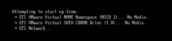

I P2V a Windows 10 desktop to a vmdk file and I cannot get it to boot in VMware Workstation.
What am I missing? Any help would be great! Thanks.

This information will be helpful:
1. Did the conversion finish successfully?
2. Did you p2v a disk or the entire machine?
3. Any error messages you get will be appreciated.
Yes, conversion was completed successfully.
P2V entire computer (C:\, 2 or 3 other partitions that were included)
Error message when starting VM in VMware Workstation Player 16 Pro, it wants to go into recovery and just cannot boot up.
I am able to P2V a Windows 10 and 11 laptop and successfully load the vm in Workstation Player Pro.
I hope this helps in anyway...thanks for replying. Your time is greatly appreciated.

It looks to me like a driver conflict of some sort. Could you please remove all custom drivers temporarily and repeat the conversion?

I followed these steps and got an error. The Error is in a file attached as an attachment. I also tried to add ethernet0.opromsize="0" OR ethernet0.opromsize="TRUE" in the vmx file and it still didn't work. Any help is appreciated.

Please try changing the Boot option to BIOS for this VM.

No luck. =(

Did you try enabling "Compatibility Mode"?
