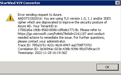

Hello, trying to run through the conversion using Starwind V2V Converter 9.0.1.268
I get the attached error. To make sure I'm understanding is this saying I need to enable TLS 1.2 or is it saying I need to also DISABLE TLS 1.1 and 1.0 to upload?

Screen Shot of error
2022-11-28 10_24_23-Window.png (9.02 KiB) Viewed 6147 times

Greetings,
Yes, enable TLS 1.2 (a good article https://www.codyhosterman.com/2016/06/f ... e-tls-1-2/)
Please note these to be Azure-side limitations rather than V2V Converter ones.

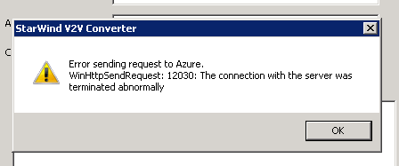

Hello I have updated my server and enabled TLS 1.2 and DISABLED TLS 1.0 and 1.1. I am now getting this error when trying to sync with Azure.
No firewalls are enabled locally. What ports would need to be opened for this to work and I can see if they are open.
TYIA
Error Message
Error Message

It looks like a communication problem with Azure. Please consider contacting Azure team to clarify this question. You could also check these links.
1. https://thwack.solarwinds.com/product-f ... uest-12030.
2. https://www.reddit.com/r/AltStore/comme ... need_help/
3. https://stackoverflow.com/questions/648 ... g-in-azure
