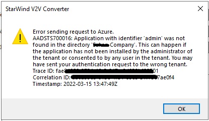

Kindly I have an issue after entering all the data needed and click on get subscription it gives me the error attached

Greetings,
This appears to be not related to the V2V converter itself. Please consider checking your AD and make sure the prerequisites for the conversion are met.

I have the Microsoft ID, Tenant domain, Admin user, and Admin Password those are the prerequisites right?
Tue Mar 15, 2022 3:36 pm
Please see this KB https://www.starwindsoftware.com/v2v-he ... Azure.html.
There is something with that specific account.

Please share the screenshot of the step where you ran into this warning.
This appears to be related to your internal account settings and hence not related to V2V converter. Please also note that V2V converter is a free software, hence the remote session is not possible, unfortunately.
Please make sure to create and register the application as described here https://www.starwindsoftware.com/v2v-he ... Azure.html.

The error as I attached at the beginning after the first step of choosing Azure then write the info needed then the error occurs
Wed Mar 16, 2022 10:28 am
Please make sure to create the storage account, application, etc.
