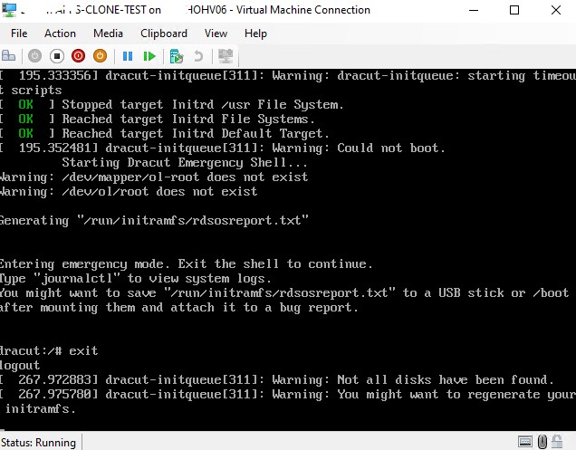

Hello Guys,
I'm new here, just testing the V2V,
I have VMWare Version 6.7 and I have VM with OS of Rhel 9 Linux.
I have successfully migrated using StarWind v2v to Hyper-V.
But upon boot up of the Rhel Linux on Hyper-V the OS is corrupted / not boot successfully.
See the error in Hyper-V
Any suggestions? thanks in advance :)
Screenshot 2025-07-01 141633.jpg (79.04 KiB) Viewed 67 times
Posts: 3620
Tue Jul 01, 2025 6:34 am
Welcome to StarWind Forum!
That's because of drivers.
Also, try GEN1 VM and connecting that disk as VHD to IDE controller.

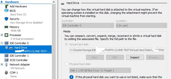

hi yaroslav, thank you.
May I know what do you mean by GEN1 VM?
And sorry, how can I do this "connecting that disk as VHD to IDE controller"
I appreciate your help.
currently, these are the settings of the migrated VM RHEL Linux.
Screenshot 2025-07-01 144656.jpg (63.88 KiB) Viewed 56 times
Posts: 3620
Tue Jul 01, 2025 6:52 am
When creating the VM, it is possible to create a GEN1 or GEN2 VM. Recreate that VM using the existing disks as GEN1. More on VM generations here https://www.nakivo.com/blog/hyper-v-generation-1-vs-2/
What I am also thinking is that the drivers (e.g., VMware tools) could be there, preventing the VM from booting up.
The problem you are getting is fairly common for cross-hypervisor conversions with any tool.
